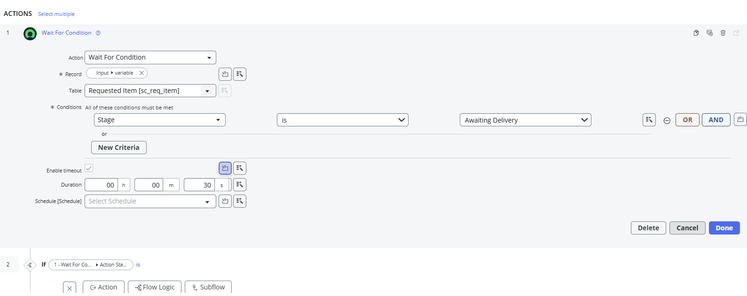

We’ve encountered a case where we need to implement a 'Wait for Condition' on the stage field being set to 'Awaiting Delivery', along with a timeout of 5 hours. If the condition isn’t met within that time, the flow should continue along a different path — ideally using an 'If' condition to check whether the timeout occurred. Has anyone implemented something similar before, or can suggest how to proceed?

Hello @Community Alums ,
To check whether the Wait action exited due to timeout, you can add a if block with condition not matching the wait condition. Based on your screen shot you can check if Stage is not Awaiting Delivery

SupriyaWaghmode
Hello @geogeorge
You need to add "5" in hours tab in front of duration field with your condition, This will work with time and condition satisfying. Then you will need "IF" condition to validate state is updated or notWait-for-Condition .png.
