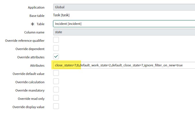

Is it an extend of Task? If so : there is an out of the box business rule that takes care of the active : Task Active State Management
Description delivered with this:
Task State Management Utility
Helper functions for working with task-type table state attributes, primarily used by the Task Active State Management business rule to set the active field based on state changes
Can be called by any server script to determine inactive states, default work, or default close states for a given table
Configurations are define in the task.state dictionary element, usually using dictionary overrides since state values vary by table.
As an example the dictionary override from incident on the task.state dictionary element:
More info @ https://docs.servicenow.com/bundle/rome-platform-administration/page/administer/field-administration...
