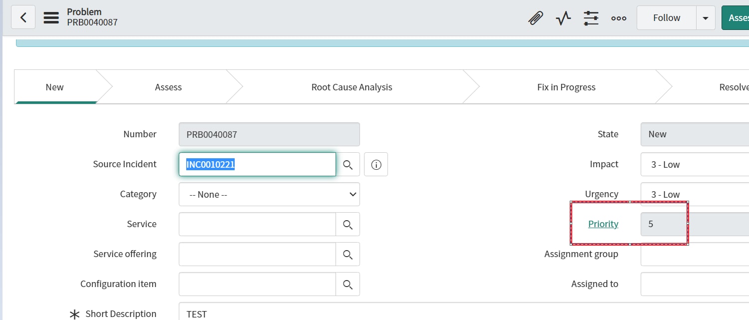

Hi Surya,
I have replicate the scenario which you have mentioned above in my PDI. I removed choice value 5 from Priority field and then created an Problem from Incident and it mapped it to a number as 5.
Reason being while copying fields on Problem table it was not able fetch any Priority 5 in selection panel and hence it mapped it to as shown below:

Okay. You need to understand how it works OOB and then only you will be able to understand what I have done in above code.
Explanation:
On Problem Form, you will see 3 fields named as "Impact, Urgency and Priority".
Priority is calculated based on value which you select in Impact and Urgency field as Priority is always read only on Problem Table.
So when you are creating a Problem from Incident, there are many attributes which gets copied from Incident to Problem and among those attributes Impact , Urgency and Priority are also there.
Now coming to your Problem:
Since you do not have Value as 5 in your Priority field on your problem form and you need to set that as 4 when a problem gets created with Priority as 5 coming from incident you need to configure the BR as per details above.
