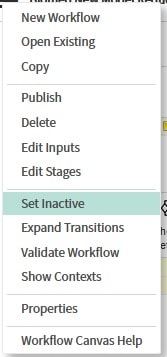

hello all,
I am very new to supporting my companies plate form on Quebec.
before the upgrade I build out a few workflows and are published well and running smoothly.
I was tasked to create a new one on Quebec and I hit the "Set inactive" button in the menu.
now i cant find where my build went.
I need help to know if there is a place to recover the build and or what happens to them when that inactive is set.
any help is greatly appreciated!
John
shloke04
When you click on the button "Set Inactive" what ServiceNow does is makes a copy of your Workflow and creates a version of it as checked out by under your Name.
So in order to republish it, Navigate to the module "Workflow Version" as shown below:
Search for your Workflow with Name contains your Workflow Name. For example shown below:
Open the One which has Published = False and checked out under your name. Once you open the record you can click on Show Workflow as shown below:
You will now get your Workflow version and you can publish it again.

Hi John
Is your workflow missing?
Did you verified in your workflow editor under filter "ALL"?
You can also navigate to "workflow versions" module and search for the same.

Can you show a bigger screenshot to show where is that menu and Set inactive menu is?

As Rohila mentioned you are probably checking with the default filter published is true.
Remove that and check
Also if using above as well you are not able to find the workflow please share the steps you are using
Please mark answer correct/helpful based on Impact.
Thanks.
shloke04
