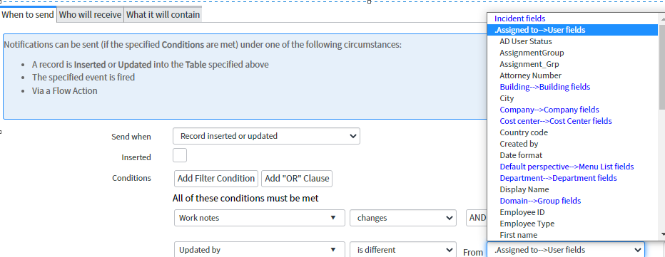

I was going to change the notification and add a condition that says Update by is different From Assigned To but when I try to add that criteria, Assigned To is not available in the list of available Incident fields.

You can select show related fields and refer below.

Please check Assigned to field in Show related fields
Or try Assigned to is different from Assigned to

I think the problem here is the Updated By is a string field and Assigned To is a reference field.
If I display related fields, the only thing there that I could possibly compare the field to is Name which is also a string field but I've tried that and it does not work.    I don't understand your comment to compare Assigned To to Asssigned To.
You could just make sure the "Send to event creator" box is NOT check under tab "Who will receive".
