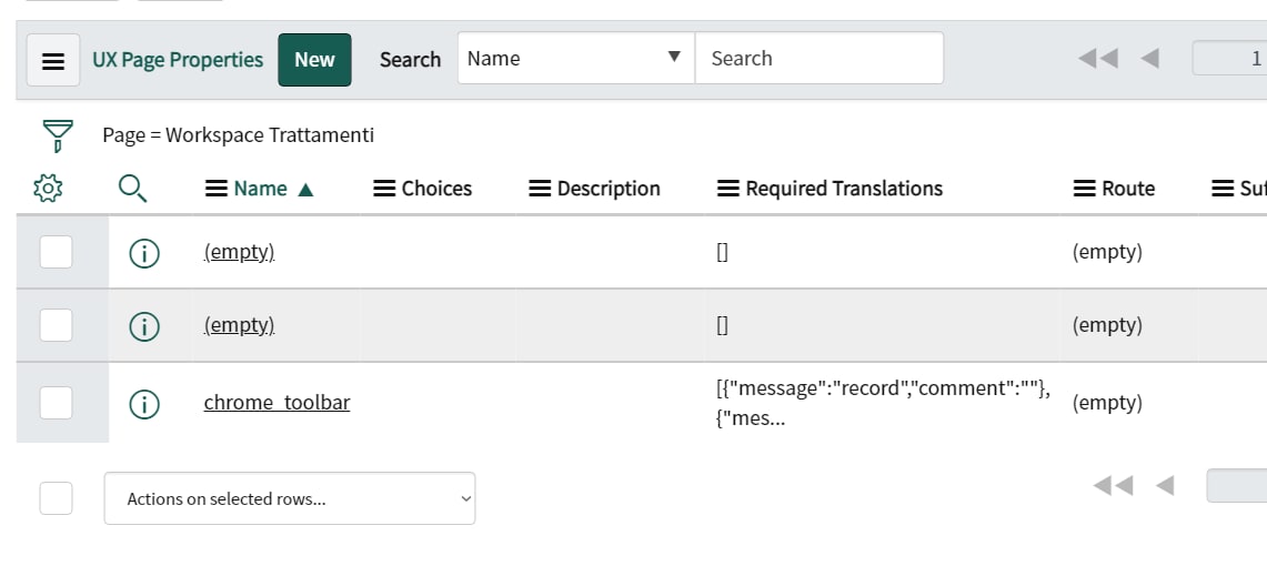

Hey Luca, After a bit of investigation, same as you I started afresh and it worked. I then went back to my old workspace and found it appears to be these empty records that are in your screenshot that were stopping it. Deleting them AND changing chrome_toolbar to type JSON worked.
18 REPLIES 18

Do you have any "empty" records in the ux page properties list? (There's a screenshot on one of my replies on this). I found thet deleting them meant it started working, as well as changing the other property from string type to JSON.
