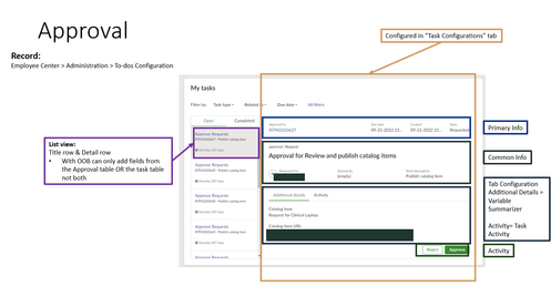

You need to set up the "to-do" view for each type of approval under to-do configuration, which is separate from the old approval widget on the Service Portal.
To configure you go to Employee Center > Administration > To-dos Configuration
To add additional information, to match what they used to see you will need to add it to primary or common info.
Additionally you would want to check your Tab configuration that you are using the correct widget in the Additional details tab, Variable Summarizer is the to get the task variables for the approval.

OK I went to check the To-Do Configuration and verified the below:
Impersonated approver on the Employee Center and still no details (variables) showing on the Additional Details screen Nor is anything showing up on the "Common info" section at the top.

Do the tabs work correctly for you before you impersonate the approver? Does the approver have the approver_user role?
06-05-2024 04:41 AM
Yes when I impersonate someone with the itil role or for a RITM awaiting my approval, all the details / tabs appear.
Yes, the group for approvals has the approver_user role.
Is there an ACL that I have to update with that role to see everything? We have a limited amount of itil licenses so I can't grant it to that role. Plus we are purchasing additional stakeholder roles in the Fall, of which, the members in this group will officially have it, so I need to have this option work without the itil role.
