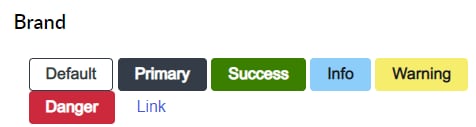

Ok so in general it's kind of try and error to find out which setting is made in the Branding Editor and which in another file? (except if you already have the experience?)
What I did on the Employee Center Branding (within the Employee Center Core application) is e.g. this:
But it looks like this:

The branding editor is in bad need of an update to support Employee Center/Pro. Some of the options in the Branding Editor GUI work, most don't because Employee Center doesn't use them. For example to change the background of your EC portal...that style property isn't in the branding editor.
I found you will have to edit the Theme associated w/ the Employee Center portal (EC Theme). If you look at the out of box EC portal and go look at the Theme associated with it you'll see all the new stuff. Most of the CSS document is commented out so don't freak out b/c it's so long.
