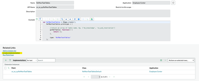

You'll need to open the "sn_ex_sp.RefNonTaskTables" Scripted Extension Point record, select the related link to create an implementation and build the array to add the ast_contract table and any other non-task tables (kb_knowledge).
You will then be able to select this table in the mapping.
There another Scripted Extension Point, sn_hr_sp.TodoNonTaskTables, you should update as well.

@Susan Britt This looks like what I'm looking for, but there is a read only protection on this policy. Do I need to submit a case to have them insert the values?
No, if you select the "Create Implementation" related link on the read-only version, it will create a version for you to modify as needed.
