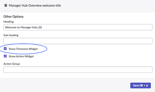

Did you check the "Show timezone widget" box in the widget options? My page design is all OOTB.

Ive just fixed it. there is a setting in the widget that needs to be switch on to be able to show the time-zones.
‎11-16-2022 07:32 AM
Nice! I just did this by digging around through the widget and script includes:
