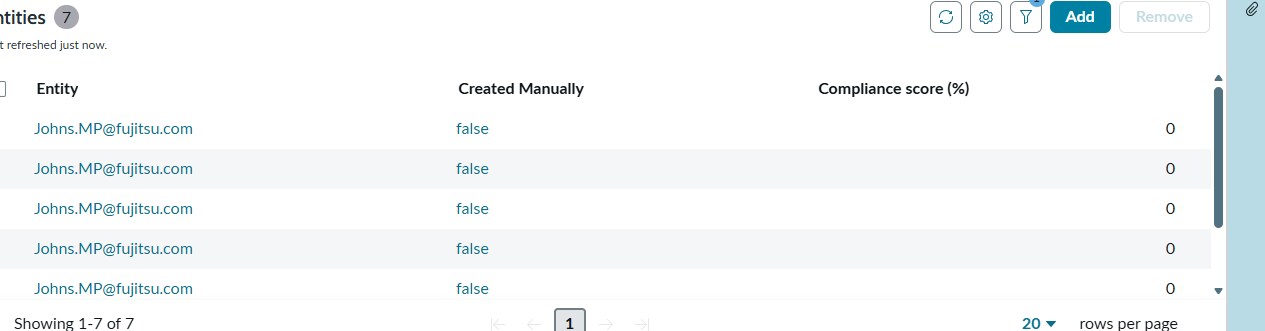

hi i am facing issue in entity type and entities i want name field as entity in my metric definition but by default it is taking email as entity field how to configure it

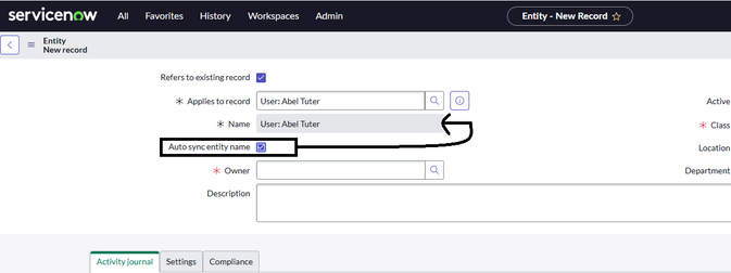

02-23-2026 01:01 AM
Hello @praharsh199 ,
Try unchecking the Auto sync entity name checkbox as it make the name field on entity read only..
After unchecking you can edit the name on the field :

can u please elaborate more thing happening to me is i have import a data in a table ,used that table in ESG module while creating entities using entity filter i have filter out the records based on particular name like give all the names of employees working under person x, it did now i wanted that entities should be those employee names but it is showing the email of x person in all records that get filter out as entities but in my previous filtering condition like give all cities based on country it gave me different cities and makes these cities as entities not the country as entity , i have attached the ss .
