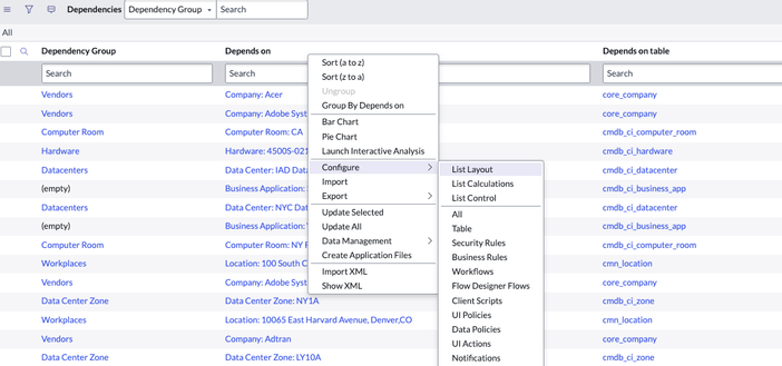

@Mickey Goldstei based on what you have shared you will have to add the fields to the list view. The grid configuration doesn't update the list layout in the classic view.
To do this you need to right-click on the table header and then add the fields. See the  below screenshot of where to click to configure the list layout. You could also do this via personalising the list but that will only be visible to you.
