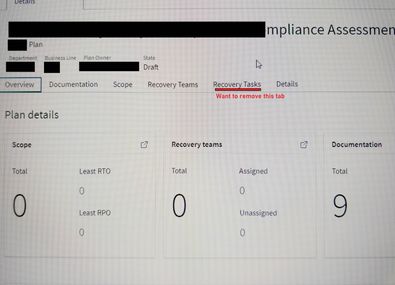

Hello Guys,
Is there a way to remove the "Recovery Tasks" tab from the workspace view?

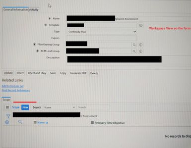

Tried removing it the usual way, by removing it from the related list in the Form View.
But looks like the "Recovery Tasks" tab is not added in the form view (Workspace View) to start with.
So evidently workspace is picking it up from something beyond the form view.
Have tried adding images to help. Hope that helps bring context.
Had to redact information.
Will appreciate any help on this.
Workspace View

Form View (Workspace)

Hi @Ronak Gandhi ,
Follow below steps,
1) Open Plan record in BCM workspace
2) Top Right corner click on profile-> Configure page-> Related items
3) Search for Recovery Tasks and deativate it
Hope this will help you 🙂
NS
Hi @Ronak Gandhi ,
Check in the Workspace view rules .
NS16
Hi @Ronak Gandhi ,
Follow below steps,
NS
Ronak Gandhi
Giga Expert
Thanks for the solution suggestions. Appreciate you taking the time out.
NS your suggestion should've work as well. I got it through this route a couple of days ago.
Steps from the native view:
  • Go to Workspace Experience -> Actions & Components -> Related Items
  • Selected Recovery Tasks and inactivated it
It basically is the same record. So both paths should work.
