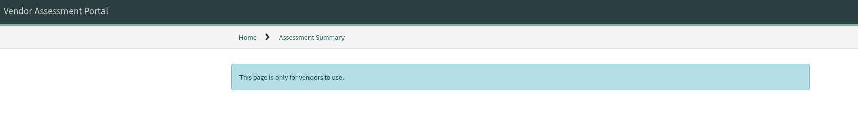

I'm sending the assessments to a test vendor and a test primary contact. How do I access the vendor portal as the test primary contact?
The contact has the vendor_contact role.
The url https://companyname.service-now.com/svdp opens the portal but I only see the below message
"This page is only for vendors to use."
Pranav Bhagat
You have to be vendor contact .Add a vendor contact and impersonate to it and check.
When vendor contacts are created, they are automatically assigned the snc_external role, giving them access to resources related to the vendor portal.

Pranav Bhagat

Phil Swann
I suggest doing what Pranav says, but have an incognito window open in a different browser - because getting back out of the vendor portal is a bit trickier from impersonation 🙂
