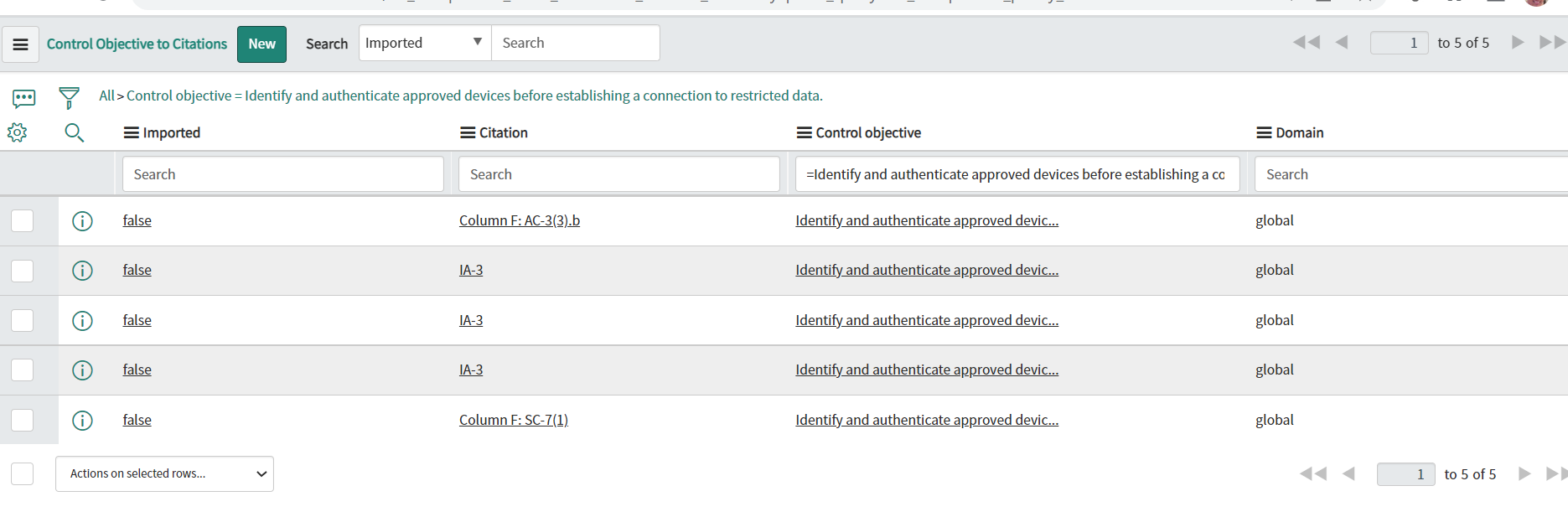

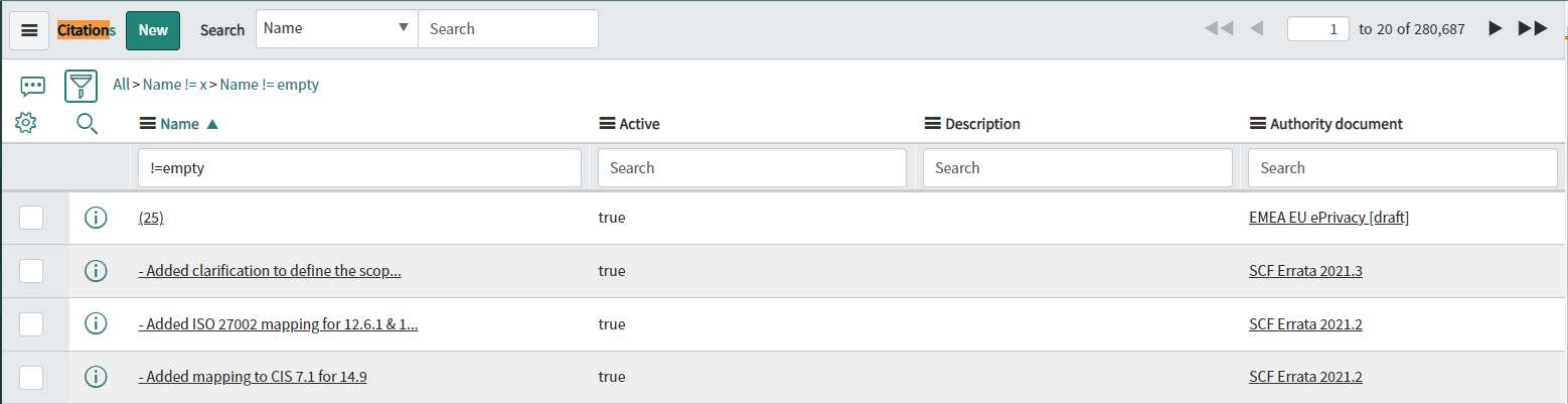

I have imported content into 2 tables in ServiceNow called Control Objectives and Citations. The source data for these tables is in a csv file in case it's relevant. Each row in the Control Objectives table (screenshot 1) corresponds to several rows in the Citations table (screenshot 2). In other words, different citations can share the same control objective. I'm trying to establish a relationship/reference between these 2 tables so that when I click on each name in the Control Objectives table, I can see a list of citations that are associated with the aformentioned name. For example, right now the list of citations for control objective "Acceptable Discoverable Information VPM-06.8" is blank and I want it filled with the associated citations from the Citations table (screenshot 3). Please find below the screenshots. I've searched a lot of places for suggestions, but couldn't find anything that I could easily understand or adapt for my problem. Any help would be greatly appreciated. Thank you so much!

This is an OOB behavior, if you have a control objective being used by multiple citation. Refer below screenshot.
Citation 2
So as you can see that the control objective will refer to both the citation in the related list.
Since you had done a manual upload using CSV where there were no relationship being given. You would be required to create the relation manually using the edit option in citation related list.

Hi Anh,
As we know Citation to Control Objective is a many to many relationship. Servicenow uses the m2m table to map these table.
Hence you can easily import your transposed CSV file to this table(sn_compliance_m2m_statement_citation)
As you can see from the screenshot below. That I have multiple records of same control objective but with different Citations and it can a vice versa case as well.
Hope this helps.
