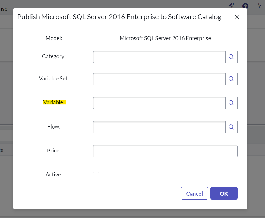

I have created UI page which is taking values from respective table
Please see below popup screenshot for reference.
I need to create copy of selected above variable to below catalog item variable related list
@Ankur Bawiskar -Please check once
For instance, I would like to copy a variable selected on ui page and make a new variable (copy of selected variable).
Instead of manually creating a new variable from catalog item page, is it possible to existing variable and simply rename it?
