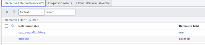

Hi @Nadir Abbas ,
An interactive filter can filter multiple tables if the association is the same. e.g.
Incident table --> Caller field
Requested item --> open for field
An interactive reference filter for sys_user will filter both reports / tables.
Look at the "interactive filter references" as below, then you should see which tables the interactive filter is filtering on.
Which tables are the two reports created on and what field is utilized in the interactive filter.

Hi @Nadir Abbas ,
