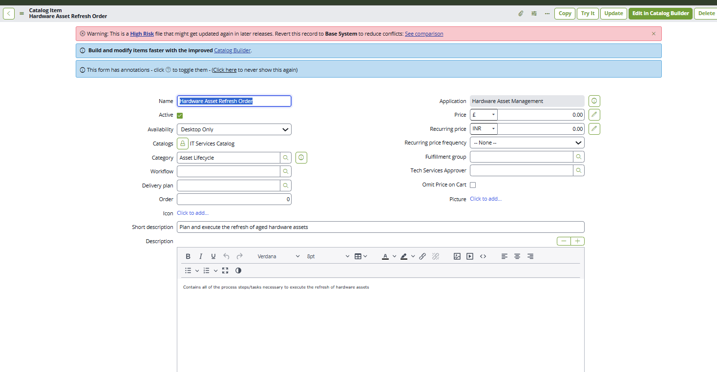

I’m trying to access an OOB feature from HAM Pro. There is an OOB catalog item called Hardware Asset Refresh Order, which has an associated flow. I activated the flow and tested it, but I’m getting stuck at the point where the sourcing task is supposed to be generated.
According to the ServiceNow Community video, once the request is approved, a sourcing task should be generated first, followed by four additional tasks. However, this is not happening in my case, and the flow is not progressing further.
I’ve attached the flow details for reference (PFA). I also tried making the Source field active through a script for testing purposes, but the sourcing task is still not getting generated.
Could you please help me understand what might be missing or misconfigured here, or guide me on how to proceed?

hi @Naveen20 , PFA the model varaible is getting populated but still there is no task getting created and i checked it, "Source Request" flow is active and published. also HAM Pro plugin (com.snc.hamp) is also in active state. please let me know if i missing anything.

The Replacement model variable on the RITM being populated is not the same thing as the Model field on the Catalog Item record itself. These are two different things, and the OOB business rule checks the latter.

1)yes procurement plug in is there
2)Can request be sourced" business rule in active state
3)you mean to say check it manually?
4) i opened BR and sys ids are not matching i didnt even touch it why would OOB values mismatch? ( i mean the sys id s are of Hardware Inventory Stock Order cat item) but here we have hardware asset refresh order catalog item
