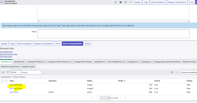

Step 1 : Created select box
Choices - 1.choice_1
                 2.choice_2

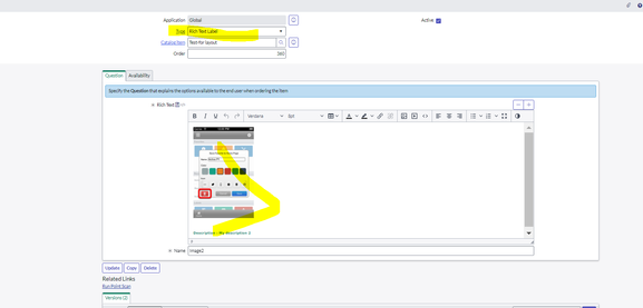

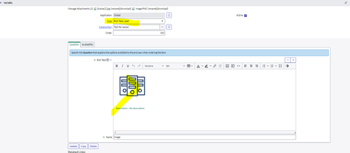

Step 2 : Create rich text label for each choice and added image & description into it.
Step 3 : Written UI policy to hide & show rich text label depending upon select choices

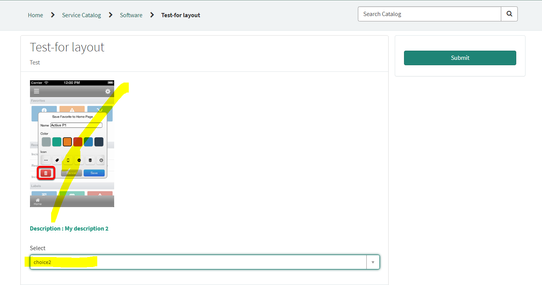

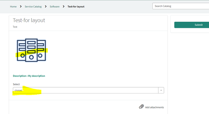

Output :
                 2.choice_2
Output :
