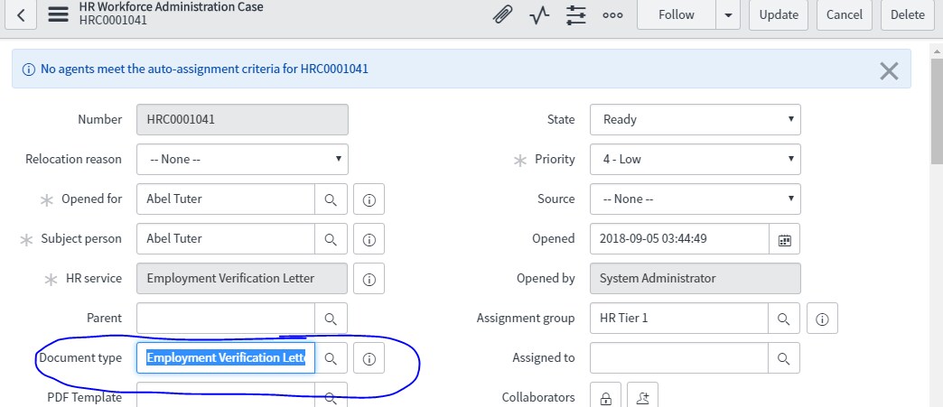

Hi ,
I am trying to generate document for OOB "Employee Verification Letter" . After the case is created , i impersonated as assignee and previewed the document and clicked on Generate. But the document is neither  getting generated nor getting attached to the case. Am i missed anything ? Please help.

I am trying to generate PDF through Automatically Create Draft Document. But I am not able to generate the document or the document is not getting attached to case.
Is there any miss from my end.
Can you pls confirm in the HR Service configuration if the case option has selection of 'Automatically Create Draft Document '
After this, once you create a case in HR workforce administration case do you see this option ?
Next step is it to assign the case to a HR tier 1 group member and move the case  to work in progress, then impersonate as the assignee and the buttons will show up
