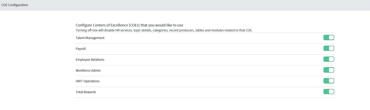

I have created a new COE. It was automatically added as an answer to the "task" interceptor, but if I go to the "COE Configuration" page ("hr_license" ui page) I cannot see my new COE in order to be able to activate/deactivate.
Reviewing the UI page, the COE list to show is retrieved from the table 'ua_entitlement' in which we don't have write access even if an acl is created.

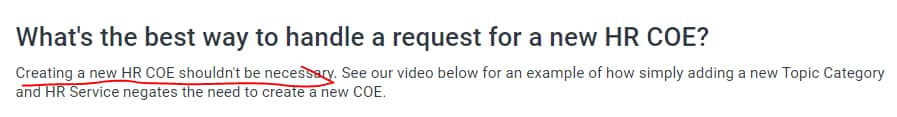

I would say best practice is not to create new COEs unless you have no option due to must have business security requirements etc. You can usually get around the need to (and the work) just by creating appropriate Topic Categories and Services. The link below re-enforces this belief from ServiceNow themselves:
https://community.servicenow.com/community?id=community_blog&sys_id=9eb3221fdbf7df0067a72926ca96199c
The COEs Configuration page only shows the pre-defined COEs in the HR Service Delivery application that extend the HR Case [sn_hr_core_case] table. You can turn of any COE you don't want to use there.
