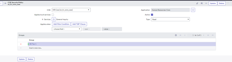

1) If you want to restrict cases of particular HR Service of COE then you don't have to select "Applies to all services" checkbox. You should select that HR service in "Services" field as below.
2) Is COE of HR Service "Benefits" is HR case ?? If you go with point1 which I mentioned above the you will be able to select only those services which are part of that COE.
3) I tried it for "General Inquiry" HR service of HR case COE and it worked perfectly fine. HR Tier 1 group member is able to see the ticket & HR Tier 2 group member is not able to see the ticket.

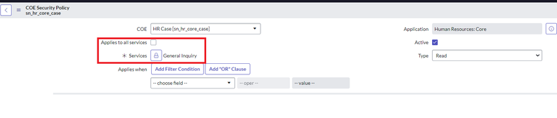

Is this not working only incase of inbound email cases. have you checked for the cases normally created.
make sure that correct COE table is selected. and as Sandeep mentioned, applies to all services check box should be unchecked.
