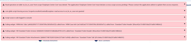

I recently had help with auto-filing a form date field, using Script Include and Client Script.
As an Admin Testing, it works perfect.
However, when I test as a Manager (non-ITIL nor Admin), I get these many errors.
 How do I get rid of these?

@Hola Ola Please see if any RCA records are invalidated due to which the errors are appearing.
brianlan25
Check the execute ACL on the script include I bet it is set to admin. Since end users will be using it I would set it to authenticated users. At the bottom of the Script include you should see an ACL tab like in the below screenshot.
