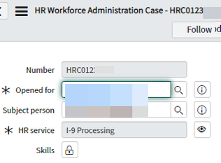

Thanks for your response. This gives me additional areas to look into. I did find a minor issue so far which is when you open up a case for that particular HR Service that predates the transition of COE's they still show under the original HR Talent Mgmt COE they were added to. However, future created cases now appear under the HR Workforce Admin COE.
Case Predates transition of HR Service from HR TM COE to HR WF Admin COE
New case created after the transition of HR Service from HR TM COE to HR WF Admin COE
