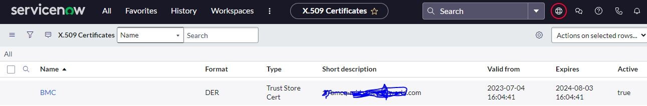

Thanks for the reply.
Yes. The certificate is already available under x.509 certificates list.
My question:
How we connect this certificate to REST Message POST Method to test the connection between ServiceNow to End Point.?
This certificate is nowhere connected to BMC Remedy Flow Designer or REST Message.
Do we have any place where we could connect this certificate?
Could you please suggest any idea.

Hi Aniket,
Please refer the attached screenshot and suggest.
Mutual authentication profile is Empty and No Protocols listed.
