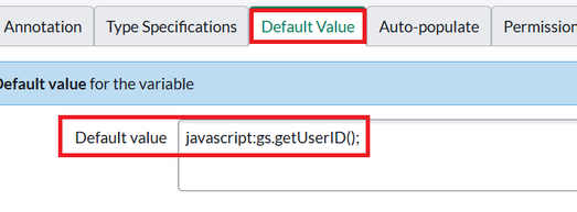

Hello @NishaB
You can configure as below:

Hello @NishaB
Steps to auto-populate field based on the currently logged-in user:
- Set Default Value for the Variable:
javascript:gs.getUserID();
Result:
Note:
- This method works when the variable is of reference type pointing to the sys_user table.
- If the variable is of text type, a Client Script is required to fetch and set the user's name.
