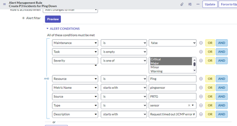

Above condition used for P3 incident.
Above condition used for P2.
Above condition used for P4. Above three multiple priorities incidents are created for same device at the same time. alert conditions are different but it is creating at the same time.
