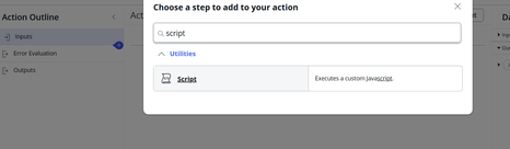

Just a quick update i found that Utility Actions Spoke is not available for PDI's hence the script action is not available.

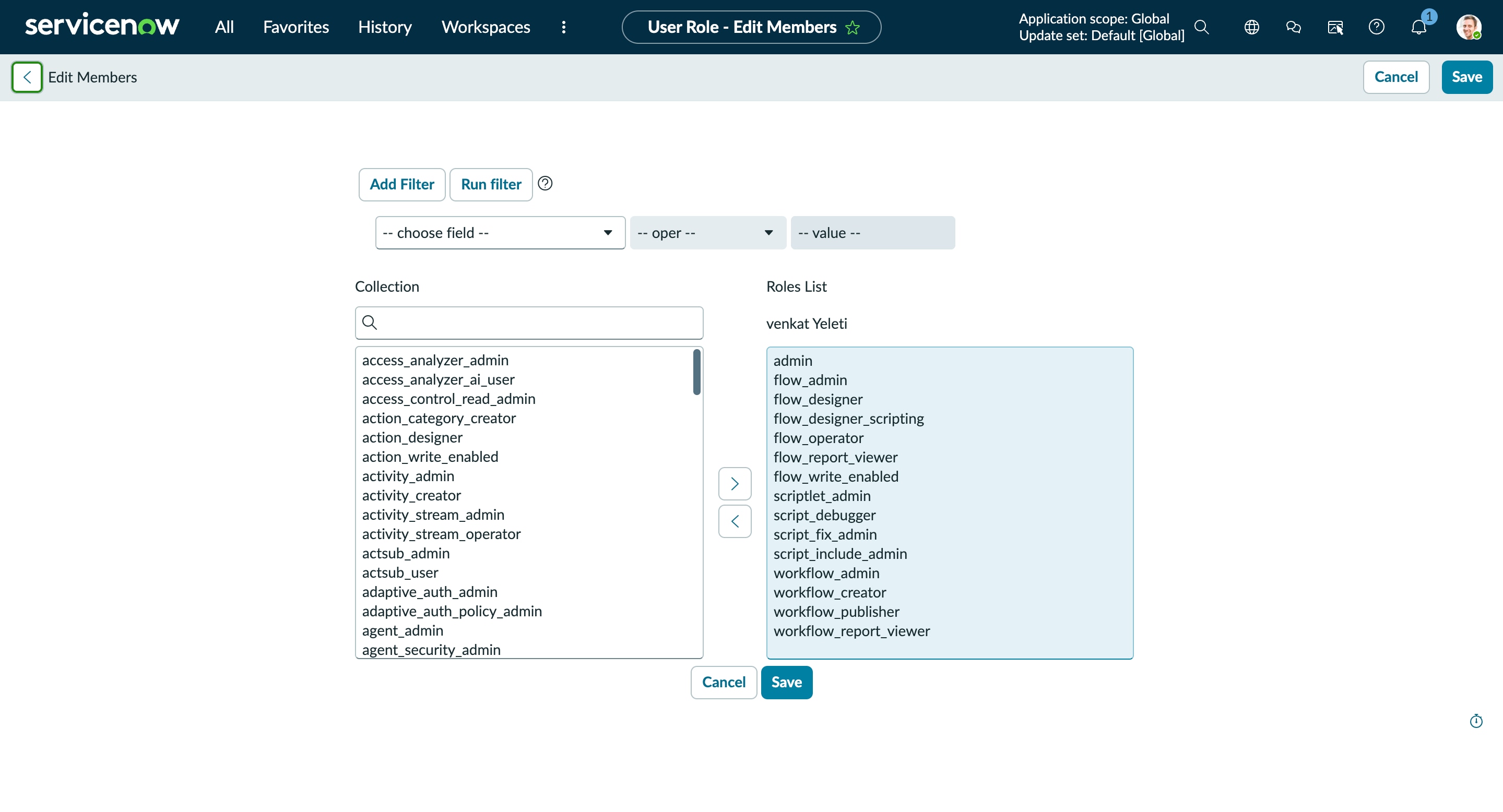

Sorry for the confusion caused by the attachments, as you can see in the latest attachment im unable to see the script option.
For the access related issues i've tried as an admin & created a new user with all the admin previlages to system, flow designer and scripting.

there nothing like script in flows action,
you need to use Actions for scripting ..
