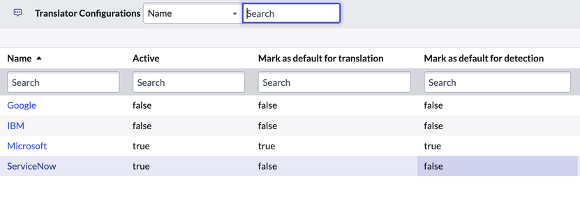

We want to enable Dynamic Translation for Live Agent chat only.
I have created a Translator Configuration but the third party service we are using cannot detect language but will translate a language if correct source and translate language code is provided.
Is it possible to read the data user is sending to agent, translate it and then show the translated text to agent and same needs to be done for agent to user?
Any inputs/suggestion is appreciated.
Alex Coope - SN
@Yousuf Kamal,
I'd be curious to know which provider (MT) you are using, because I'm not aware of any of the big ones that can't do Language detection,
However, for your scenario you could in theory use our own. For example, in the "Translator Configurations" you could (in theory) set ours (the Servicenow config) to be the default for Language Detection:
I know in my screenshot it's showing as "false" that's just the default behaviour and in my demo instance I'm using the Microsoft Azure language detection mechanism. So if you set your "ServiceNow" "Mark as default for detection" to "true"  then leverage which ever other provider you want to use then I would expect it to work,

Yousuf Kamal
Kilo Guru
@Alex Coope - SN
Thank you for the reply. I am implementing this solution and will update later if it works. Initially it seems to be working fine but I am not sure where exactly does this Detection flow come in to play as generally translation flow is triggered.
@Yousuf Kamal,
Typically, even if you were to use an MT's language detection feature, it would send the "string" to the MT to detect the language (we would hold that value) then use it when we then send the string to the MT to translate (two separate flows for two separate stages, so to speak),
