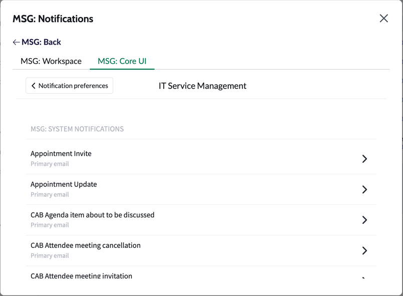

In this article by @Mark Roethof we learn how to set up and use the new Multi-lingual notification support. I've got a need to be able to translate the Name of the notification in addition to the subject, body, etc. of the notification. Is there any guidance available on how you can have a localized version of that Name so that when someone looks at Notification Preferences, they can see the Name of the notification in their preferred language?

So ootb, indeed the notification names are not translatable, as can be seen when I look at the preferences modal you'll see there's no prefix:

If we now check back on the notifications preference, we can now see that they are translatable:
