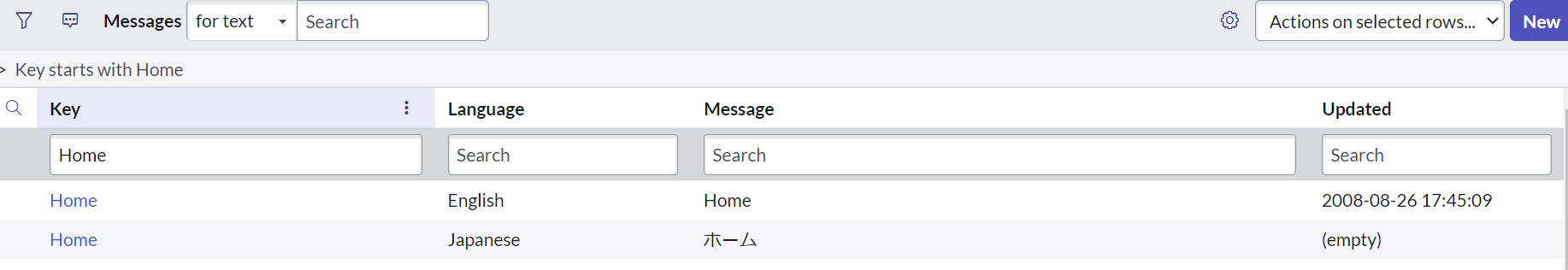

Hi, ALex Coope,
I don't think it is because of the browser cache'ing issue, you can see my picture, I have already set translation in Messages and Translated Text table, and I log out and log back, but it still not translate into japanese.

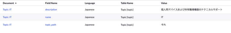

So, in your first image, not all of those strings are MSG entries (e.g. the "Service Request" string for the Topic would be a TRT [sys_translated_text] entry,
In my portal example, I have "IT":
(it's important to note, that this would also be true for "Workplace" in my screenshot). The same topic name is used next to the word "Browse",
The translations then for "IT" are held in the [sys_translated_text] table like this;
Specifically the "name" entry.
Side-note, in Japanese "IT" is used in the same way as in English, hence I haven't translated it,
