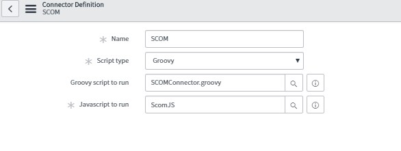

You can check the groovy script on the Connector definition of SCOM > SCOMConnector.groovy
By default, "Error" is mapped to Major Severity for the event.
String scomSeverity = params.get("SCOMSeverity");
if ("Error".equals(scomSeverity)) {
event.setSeverity("2");
} else if ("Warning".equals(scomSeverity)) {
event.setSeverity("4");
} else if ("Information".equals(scomSeverity)) {
event.setSeverity("5");
} else {
event.setSeverity("3");
I'm not sure you can map out the defined severity coming from SCOM Alert from this script.
