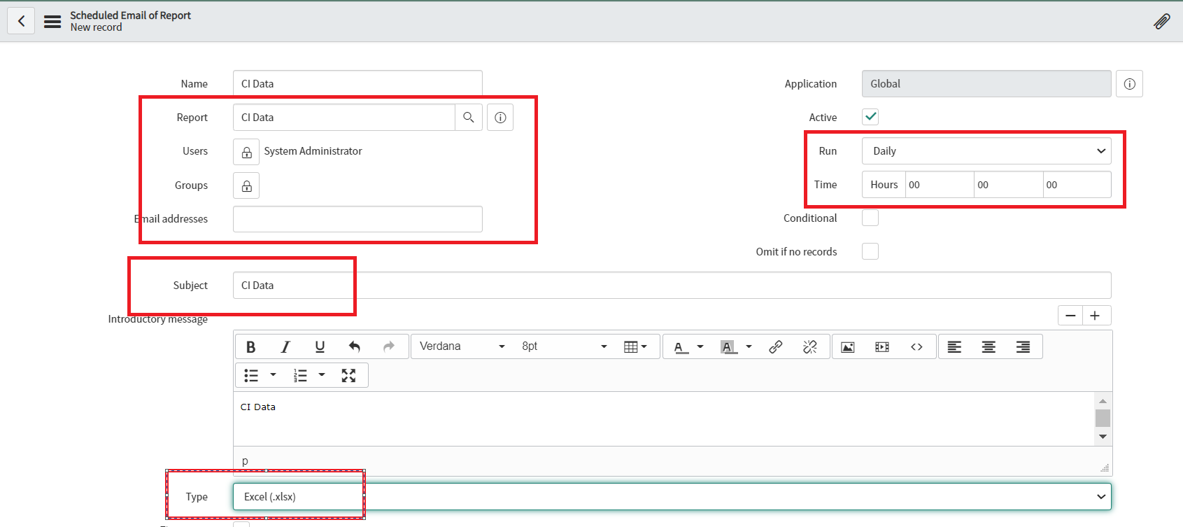

Couple of things to mention here to achieve what you are looking for:
1) When Discovery gets completed, in Configuration item table there is a field named as "Discovery Source" which gets filled in and created by must be a Mid Server Service Account.
So you can build a report as below and have it Scheduled automatically to send a report of these devices being discovered by Discovery . This will help you eliminate manual need to export data in Excel every time and send it to the recipient.

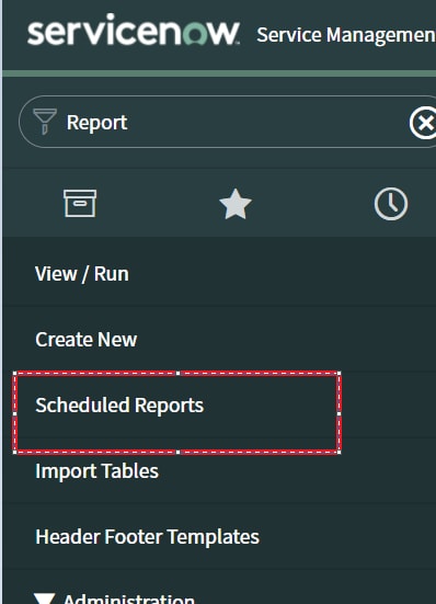

Now Navigate to Scheduled Report Module as shown below:
Click on New button and Select the Report you have created in steps before and you can also choose the Format in which you want to send like below:
Excel or PDF
Also Frequency can be selected like when you want to send along with Some custom message in Subject and body as shown in screenshot below:

I would encourage you to follow this approach as it will help you to eliminate manual extract of Report every time and will be automated as well.
Please let me know if you have a query on this.
