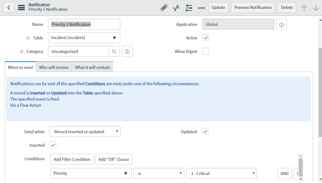

I am trying to fire a notification when a priority 1 incident occurs. Here is the screen shots.
It works correctly when I create a new priority 1 incident or update the incident priority using "Update" button.
However, when I create a backgroud script and update the priority to 1 but the notification doesn't fire. Is there any advice? Thank you in advance.

Hi Emily,
In your background script, you have gr.setWorkflow(false); this prevents business rules and workflows from running, hence your business rule does not fire the event.
Phuong

‎08-13-2019 05:01 PM
Thanks! It worked.

Hi Emily,
Strange. It should work. Can you confirm the recipient list once & make sure it has some values, also try chcking the Send to Event Creator flag to True & see the result.

Hi Emily,
May I know why do you need ' gr.setWorkflow(false);' in your script? Can you please remove this and check?
