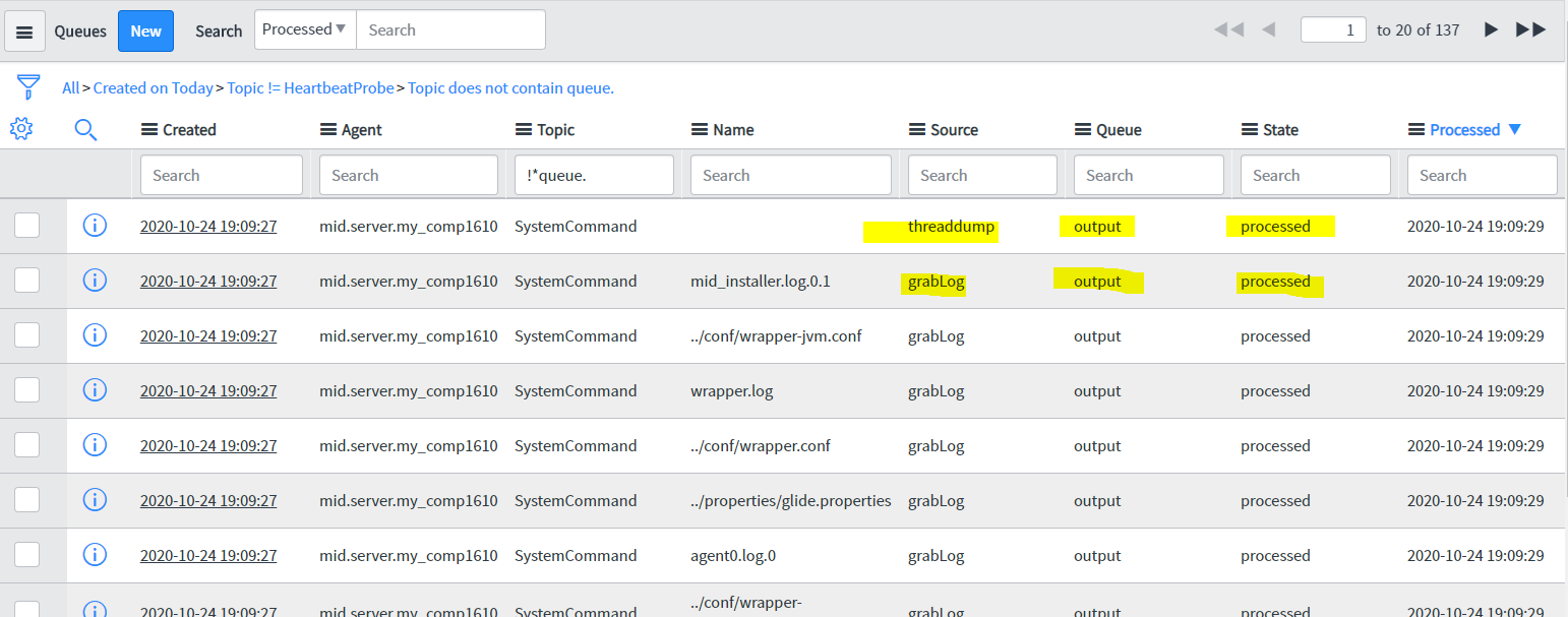

hi i just now ran the ui action,
but in log files i dont see any logs generated today.
In ecc queue when i ran the ui action,
i got few logs as input and other few output
I am seeing wrapper.log record and i see a text payload file in both input and output queue.
what is this mean?
Log files don't generate daily, they extend until they reach a data size limit.
From your screenshot, the two files at the bottom of the list are the logging files currently being used, this is evident by no end date.
The wrapper.log is the Tanuki java wrapper that hosts and operates the MID service.
The agent0.log is the log file that tracks information regarding the MID servers operations.
9 times our of 10, you want agent0.log.0.
The input from that operation should have a payload.txt attachment file you can download.
Those files are sharded when they reach 10MB, so if you need older information move on to agent0.log.1, etc.
As Kieran says, you may occasionally want to look at the Wrapper log to check for restarts and unhandled exceptions.
    - Tim.
