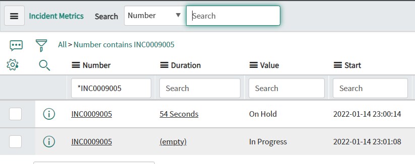

Your scenario is not quite clear for me. Do you mean if incident current state is "On Hold" then you would like to calculate the time for which it is on hold? (because current state duration values are not stored on incident metric table).
If this is the case then currently we do not have any way to calculate time difference on client side. You would need to achieve this with server side script.
I would suggest to go with Display BR where you can calculate date difference from Today's Date and start field from Metric instance table as shown below. The start field on incident metric table stores value when incident was moved to that particular state( in your case it is on hold state).
Once you calculate duration in display BR then you can store that value on scratchpad object and access the same value in on load client script and perform your further task.
