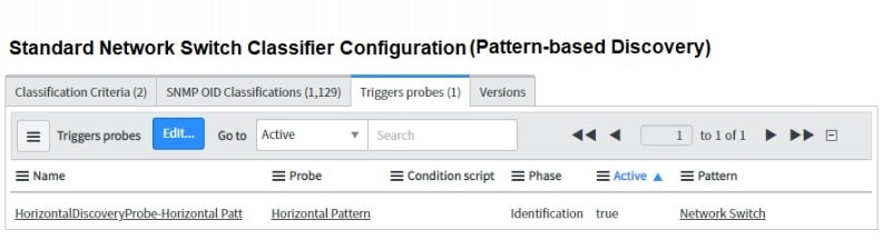

In the Discovery configuration - you will know if you are using Pattern-based discovery by looking at each Classifier (Discovery Definition>>CI Classification). There will be an entry called HorizontalDiscoveryProbe-Horizontal Patt that will be set to active. The specific pattern will be in the Pattern column.
For example, the configuration for Pattern-based discovery for a Network Switch is as follows (Discovery Definition>>CI Classification>>SNMP and select Standard Network Switch):
