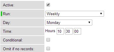

Hi, I had a same question from manager if it is possible to schedule report only for workdays.
My thinking without developing anything is , that report could be scheduled not one time, but 5 times for each work day separatelly as on the below image you can see that if you select to run report WEEKly, then you can select exact day.
If you do it once per work day = 5x scheduled report, finally this is the solution that you get reports only in work days.
