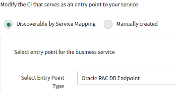

Hi - currently fighting with a service map.
In theory, I have an oracle RAC 19c database.
I (believe) I want to connect to the oracle rac 19c database using a 'create connection' using an oracle rac db endpoint.
Has anyone successfully had this done?
