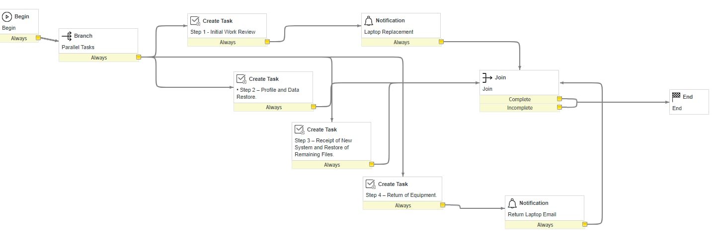

I am trying to setup 4 parallel tasks. I want task #3 to wait for completion before firing off the task 4. How do I achive this?
You need to have Step 3 connect to Step 4. Step 4 will then connect to your Join.

TrevorK
Here is an example of running parallel tasks, and waiting for them to be completed before moving forward. This means that the tasks can be completed in any order but must all be marked as complete before moving on.
In order to have Task 4 start AFTER Task 3 has been completed you put Task 4 immediately after Task 3. So Task 3 connects to Task 4. Task 4 connects to the Join.
Does that help?
Shashikant Yada
Connect flow in this way:
Task 3 activity (Once closed) -> Create Task 4

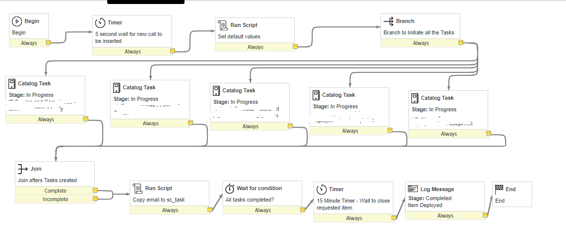

Hi David,
In my case, I have to create 4 tasks sequentially, when one task is closed then the flow moves to the next task, and two parallel tasks gets created and then the result is joined.
Refer the below screenshot, this might help.
Ajay
David Santel
Giga Guru
I need to wait for task 3 to completed before I run task 4. I would also like task 4 to show up but not run until task 3 is completed.
