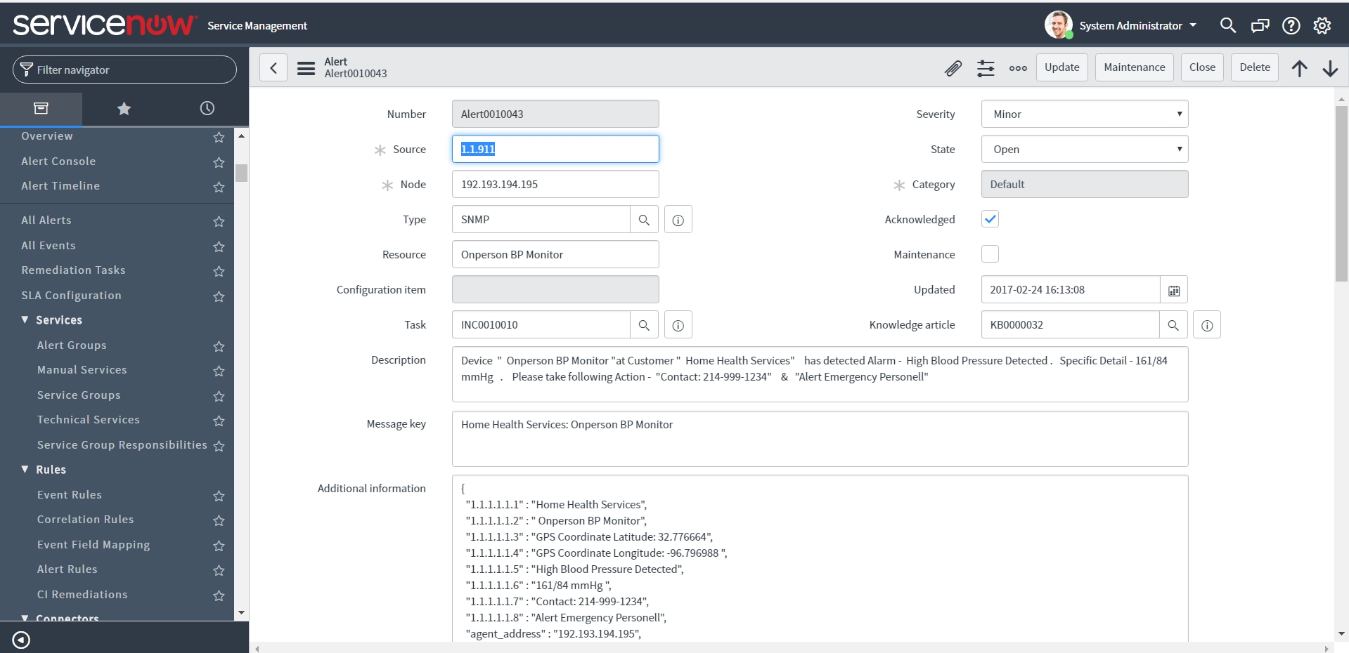

Doing some digging around and reading up, understanding the event flow to alert to incident. I think I am fairly up to speed on the basics now. I created some rules and mapping to move the events into alerts, then auto create incidents. I tested some push notifications using JSON from command line. I would like to move executing an action in PRTG with a python or PS script that sends the variables over to my DEV service now. If you have anything that helps with this, I would greatly appreciate the help.
Here are a couple of items I am working on currently -
1) Instead of using the PRTG built in SNMP trap, I would just execute a trap with my own OID's (mostly because I can then split each Message value in a separate varbind -
so - for example - Below is a hypothetical trap that I will execute from PRTG (or some other tools which monitor IoT gateways), to the MID -
sudo snmptrap -v 1 -c B1gS3cr3t 192.168.1.214 '1.1.911' '192.193.194.195' 6 911 '' 1.1.1.1.1.1 s "Home Health Services" 1.1.1.1.1.2 s " On person BP Monitor" 1.1.1.1.1.3 s "GPS Coordinate Latitude: 32.776664" 1.1.1.1.1.4 s "GPS Coordinate Longitude: -96.796988 " 1.1.1.1.1.5 s "High Blood Pressure Detected" 1.1.1.1.1.6 s "161/84 mmHg " 1.1.1.1.1.7 s "Contact: 214-999-1234" 1.1.1.1.1.8 s "Alert Emergency Personnel"
This actually allows me to use one varbind for each field, and then map to a different field in the event rules and enrich the message as it is pushed into a alarm. Beyond that the rules are simple to create the incident.

If you're using Jakarta then you'll need to use the new web service endpoint and send your event in a JSON format. Here's an example that should work (just replace the USER, PASSWORD and INSTANCE-NAME text with your own values):
curl -v -H "Accept: application/json" -H "Content-Type: application/json" --data "{ \"record\":
\"source\":\"SCOM\",
\"event_class\":\"SCOM 2007 on scom.server.com\",
\"resource\":\"C:\",
\"node\":\"name.of.node.com\",
\"metric_name\":\"Percentage Logical Disk Free Space\",
\"type\":\"Disk space\",
\"severity\":\"4\",
\"description\":\"The disk C: on computer V-W2K8-dfg.dfg.com is running out of disk space. The value that exceeded the threshold is 41% free space.\",
}" -u USER:PASSWORD "https://INSTANCE-NAME.service-now.com/em_event.do?JSONv2"
Let me know how you go.
