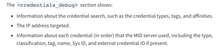

As Robert said, this is a very common generic error for access to target devices to be discovered.  I recommend adding debugging info for credentials Credentials Troubleshooting doc here (London)
This will add info to the INPUT portion of classification probe that helps deduce what is going on including:
  • Cred types attempted
  • IP addresses of the machine(s) that were targeted
  • Success/failure response of each cred attempted

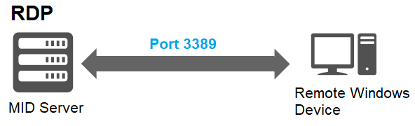

Step 1 (Validate Credential using RDP):
RDP from the MID server to the Remote Windows device to validate the Windows credential as you have done.  This is excellent way to validate the credential.  BUT this step only validates the credential - because RDP communicates on port 3389 to login to the Remote Windows device while ServiceNow Discovery uses a different range of ports for login and discovery communication.
