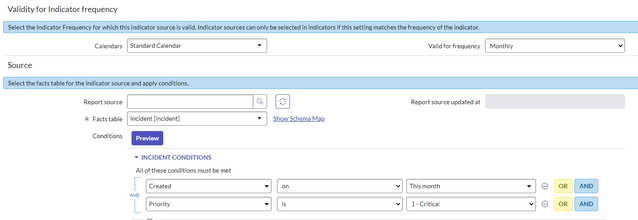

1.
Create the condition on the indicator source as below (Monthly frequency):

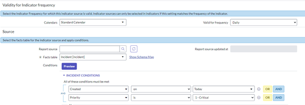

2.
Create the condition on the indicator source as below (daily frequency):
And create the widget with the time series condition:

I have done the first one, the widget in the dashboard is displaying only for 1 month
i.e only data of Jan

Hi @Rahul Raja Sami ,
According to both the first and second one, you need to due a historical data collection back 6 months to show the data that you would like to have. If you don't do this, then you wont have any data. in the dashboard.
