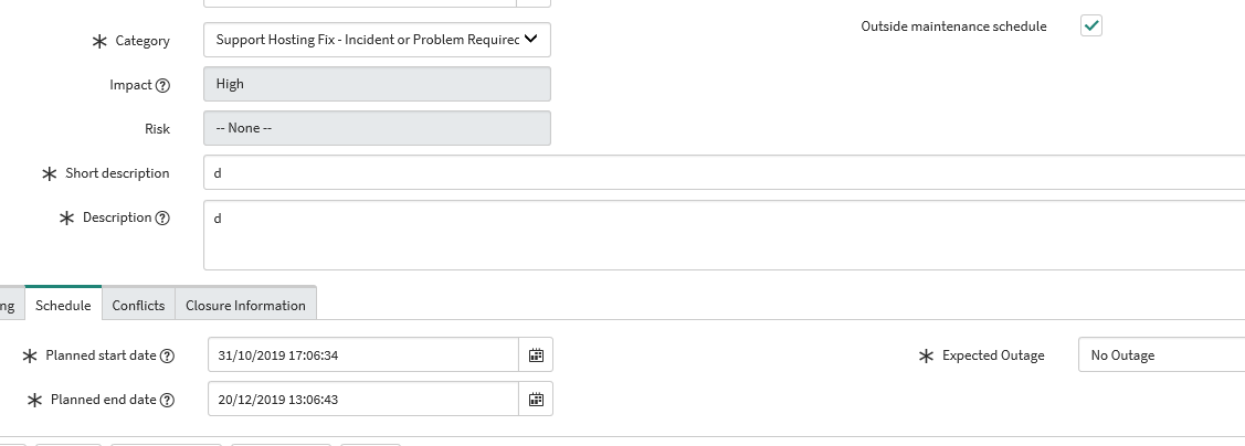

This has helped me. I think there maybe a floor though as I added a schedule for 01/11/19-30/11/19 and when I changed the dates to before and after those dates the outside maintenance window is still checked.
I understand why, but it would be good if there was another property or element of the script that understood that my dates are within the planned dates window.
