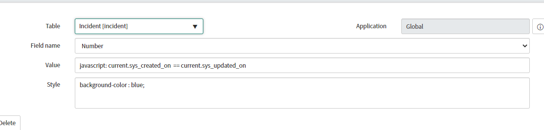

I have a requirement where I need to configure the "Number" field to change style when it's been updated and then change back to normal once the update has been seen by a user.
I've configured a field style to make the "numbers" bold and to display a blue dot, but I'm not sure how to only have it appear when the record has been updated.
