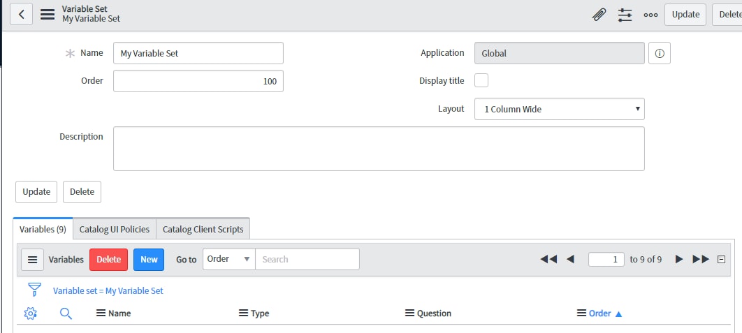

Create 1 Variable set as
Than Create Variables inside the variable set as

Hi Dinesh,
You could use nested containers.
<Container 1 (single column)>
<Container 2 (double column)>
column 1: variable a,b,c        column 2: variable d,e
<End Container 2>
variable f,g
<End Container 1>
You could use the same construction with a variable set.
Var set 1: single column
Container: 2 column
Hope this helps.
Cheers, Gerrit

Hi dineshchoudhary,
You have to give the container name , type and order . Try according to this .
If Suppose,
1) Start - Container start Type - 10
2) Container name (a, b, c ) - Your container type - order (20,30,40)
3) Split - Container Split Type - 50
4) Container name (d, e) - Your container type - order (60,70)
5) Formatter - Container End type - 80
6) Container name (f , g) - Your container type - order (90 , 100) - In Type Specification (Variable Width = 100%)
Let me know, if you have any questions.
