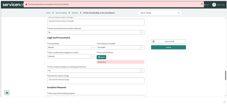

I need to submit a Catalog Item during a test, but there is a mandatory attachment field.
The issue is that when using "Set Variable Values" the input appears as a String/Single Line Text field, so I can't mock a generic image (for example) which would be sufficient, since the field itself isn't the focus of the test, just a requirement for submission.
Even using a "File Attachment" parameter doesn't seem to work. Does anyone know a workaround for this to submit the form via ATF?
It is worth mentioning that I have already tried using a sys_attachment sys_id in this input. I also tried using a different "Add Attachments" test step, but it only works for that OOB field at the bottom of the form, not for custom variables.

The solution that worked for me was using the sys_id of a sys_attachment record directly in the string input generated by the attachment field, as suggested.
However, the important detail is that the "Table name" column is empty; presumably, if the test were performed by a user with access to that specific table or an admin role, this wouldn't be an issue.
Thank you all for the help!

Unfortunately, it still hasn't solved my problem. For some reason the variable does not accept even an valid attachment sys_id.

For custom attachment variables, ATF’s standard Add Attachments step doesn’t handle them well. A common workaround is to create a dummy attachment via a server-side script and associate it with the relevant record before submitting the Catalog Item. Passing the sys_attachment sys_id directly usually won’t work because the variable expects a different value format.

I managed to get it working by using a sys_id of sys_attachment record directly in the string input, but the catch is: the Table name collumn is empty.
The impersonated user's lack of access likely affects the reference used in the form.
