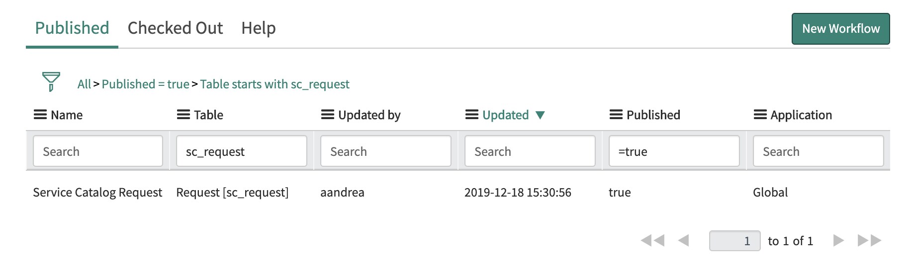

05-06-2020 09:22 AM
As seen in screenshot you have edited the Out of the box "Service Catalog Request".
This is not recommended since the same workflow is used throughout the instance for Request table.
For creating catalog tasks you should use Workflow on Requested Item (sc_req_item) table
I would suggest you revert the Service Catalog Request to it's original version and make changes to other workflow on RITM table
05-06-2020 09:30 AM
What's the best way to revert the OOB "Service Catalog Request" workflow to its original OOB state? Pretending that I am in production and made this silly mistake.
Also, I have checked the list of workflows. I can see two for sc_request but have different application scope. Is this something to be worried about?
FFor the catalog task workflow, it is actually associated to the sc_req_item table.
