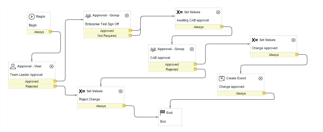

Currently my workflows are setup like so:
Note: Bolded Items show the type of workflow used and based on full approves no rejects
"Begin Workflow > Approval - User (Team Leader Approval) > X=Set Values
= Awaiting CAB Approval > Approval Coordinator "CAB TEST" > X=Set Values = Change Approved > Create Event Change Approved > End Workflow"
Following on from the above. The main problem I was facing is that within the first part of the approval process Approval User (Team leader Approval), this was setting the field within the change "approval" to Approved.
THE WORKAROUND
Within the Approval User workflow I had to change the "Approval Column Name" to a random field that wasn't being used on the form our case "u_solution". What this did is stop the change using the "approval" column and setting the change to approved, however, within the approval history, once the team leader approves the change and the next set of users are added for CAB/Test approval, the team leader state now show "Requested" See screenshot attached for an example.

There's probably more than one thing that could cause this, but whenever I see strange things happening with workflow approvals it's often related to the incorrect 'Approval engine' setting for that table. If you're going to use workflow approvals, you should turn approval engines off for the 'change_request' table (and probably others). I'd check that first.

‎05-21-2015 09:38 PM
Thansk Mark!
This has really been helpful! Turned it off and it worked straight away!
