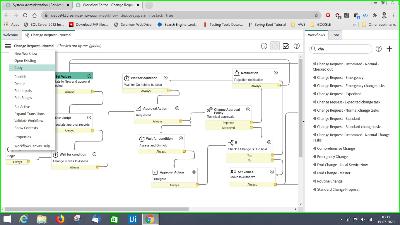

Please follow below screenshots:-
Step 1:- open the OOB Chage work flow in workflow editor and choose copy from context menu.
Step 2:- Give a name to your change workflow:-
Step 3:- Set Inactive to make inactive the OOB Change Workflow.
Step 4:- Open You customized Workflow in workflow editor and set your trigger condtions in properties.
Step 5:- Publish your Customized Change workflow and make it active.

It is not best practice to change the OOB Change Workflows Instead you should copy the OOB Workflows and Make changes to it.
